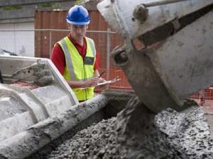

MIXING Concrete must be mixed so the Cement, Water, Aggregates and Admixtures blend into an even mix. Concrete is normally mixed by MACHINE. Machine mixing can be done on-site or be a Pre-Mixed concrete company. Pre-Mixed concrete is batched (proportioned) at the plant to the job requirements. Truck Mixing The materials are normally added to the trucks at batching plants and mixed for required time and
speed at the plant. The trucks drum continues to rotate to agitate the concrete as it is delivered to the site. Site Mixing When site mixing begin by loading a MEASURED AMOUNT of coarse aggregate into the mixer drum. Add the sand before the cement, both in measured amounts.
